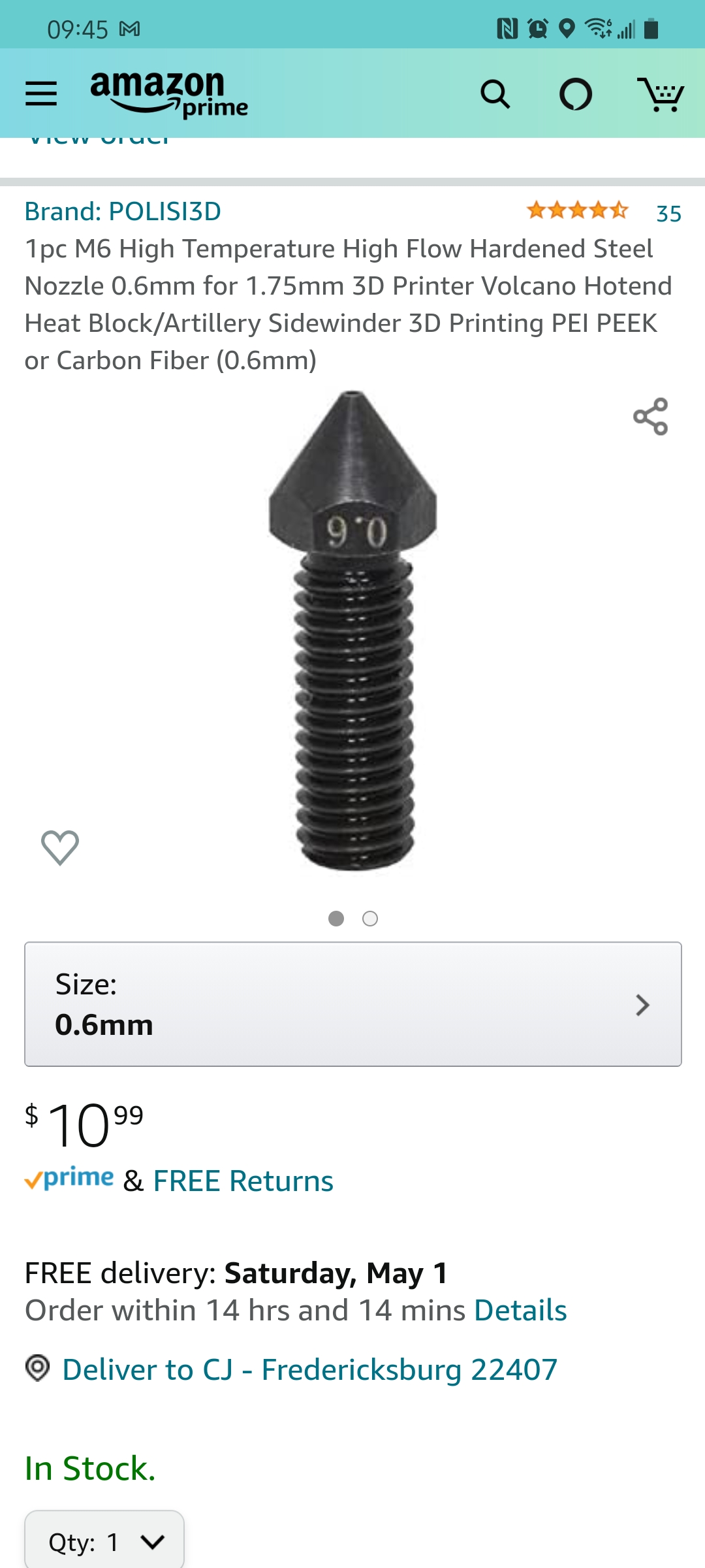

I am currently using a micro swiss m2 hardened nozzle, but switching to the direct drive there aren't as many options. I am going to try a cheaper hardened nozzle I found on amazon.

Hello everyone! We will release the nozzle in a few days. You cant use just any Volcano Nozzle because the pointyness of the "normal" aftermarket ones isnt simply enough. This will result in the tip ofthe nozzle not reaching the belt and also burning the belt with the hexagonal part of the nozzle.
